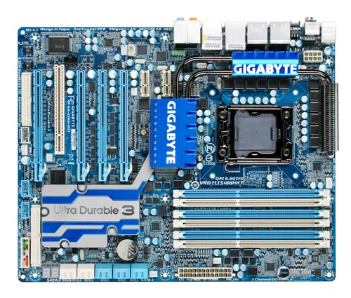

now look at the same card again and imagine it will be watercooled, like the majority that buy this motherboard will do
#1376034 by Angelitta (Power User) at 2011-02-08 13:45:50 (2 years ago) - [Quote] - [Report]Top
I'm really trying to picture it but honestly, can't see any reason why that layout would be more suitable for water cooling.
I'll admit though, I don't have experience with water cooling but I wouldn't mind learning, so if you guys can explain why that's better I'd appreciate it.

Angelitta: Look at WHY the thing are placed as they are.
I fail to see the point of providing pics for other designs that are virtually the same and, as you claim, traps heat around the CPU. Hell, the 4/8-pin is even worse placed there if you have a psu at the bottom with a short wire.
Granted I agree about the PCI-e part and the heatsink if it is flat for the purpose of putting a sticker on it, I wouldn't complain if the sink provides adequate(sp?) cooling.

#1376054 by Angelitta (Power User) at 2011-02-08 14:47:20 (2 years ago) - [Quote] - [Report]Top
Believe me, I'm looking.
The two designs I've shown, don't trap heat around the CPU area, the chipset cooler is made of thin fins that allow the air to move between them and from ... let's say a fan in front of the hard drives towards the cpu area and then it gets pulled out by the heat pump fan, if it's gonna be mounted near the motherboard connectors.
On both motherboards i recommended, the pci-ex x1 on top would be usable even if you use all three pci express x16 slots, and it would make sense to be there, for example if you'd want a sound card there (who would want the sound card ports at the bottom of the case?)
As for the 4-8 pin power connector, imagine the board with one long pci-express video card, or even two. if the cable is short and you can't route it through the back, it will have to go OVER the video cards in some sort of diagonal direction, because if you have to 2 sli cards, you'll have the sli bracket connecting the two cards, as you can see here:
So I really can't picture the power cable going over the cards, only going through the back, but then it would get trapped between the voltage regulator heatsink and the water lines for the water cooler or the cpu heatsink/fan
#1376064 by YinchieDonor (Power User) at 2011-02-08 15:29:21 (2 years ago) - [Quote] - [Report]Top
I actually have an Intel system... haven't used AMD since the Barton days. Processors i mean, I do have a Radeon 4850 as video card, where I may be biased.
The motherboard sucks for several reasons ...
http://dl.dropbox.com/u/277244/upgrades/IMG_1095.JPG
1. the 8 pin power connector is in a bad position
  If you have the psu on the bottom
    - and the cable is short, there's a chance it will touch the video cards, with cards staying at 70-90c the unshielded cable's isolation on a cheap power supply could melt and cause short circuits and unexpected reboots.
    - and the cable is long, you can move the cable behind the board and feed it from above but then it may block the airway between the cpu cooler heatsink and the voltage regulators - the air cooler is supposed to blow air through the cpu heatsink and over the voltage regulators and out of the case.  As you plan on using water cooling the voltage regulators may overheat if there's no airflow there.
So? Do you know how huge my case is? Corsair Obsidian 800D.
I am using Corsair 850Watt modulair PSU and the cables are short, at this moment I am using a extender to my Gigabyte (EX58-UD5) motherboard and it goes behind the back of the motherboard tray.
Airway? Do you know my setup?
I use watercooling. And the 8 pin power cable is so thin, it wouldn't block anything.
And the waterblock for my motherboard is thinner than all the heatsinks, plenty of space for any airflow.
This motherboard has the biggest space around the CPU and CPU voltage regulators, plenty of space for any air.
The UD5 from Gigabyte is more cramped than ever.
Compared to:
2. they could have abstained from making those waves in the chipset heatsink on the left and place a pci-express x1 slot there that would actually be useful for something, as it currently is all slots are covered if you do 3x sli. The heatsink could have been just a bit wider and maybe less tall and they could have just done a ribbed top or those fins to increase the dissipation surface instead of using a flat top just to write there the name of the card.   Now i don't know if there's some traces on the board there that would prevent mounting a pci-ex 1x but I doubt it, such connector doesn't need that many traces.
Pointless points.
For one, all heatsinks will be removed and replaced by a full waterblock.
I am never going 3x SLI, even only a small chance for a SLI. One videocard is enough for me unless I want to do something funky.
By the way, the flat heatsink is not fully flat, only the top part is flat.
3. The only PCI slot there would be covered by the cooler of the second video card - high chance of that if someone's buying such motherboard. So if this happens and guy has just dual sli, he's left with 2 pci ex, but no pci.
PCI? which noob is still using outdated hardware?
This mobo doesn't even have a IDE port.
Someone's more likely to have a pci card that he/she wants to keep like an audigy or some tv tuner- if they wanted to mount there some sound card on the last pci ex 1x or some killer nic, they could do it at the top above the pci express x16.
I use a killer nic and a creative soundcard, both using PCI-E and I am able to use both PCI-E 1x ports because my videocard will not be using 2 slots because of single slot custom bracket and a waterblock for the videocard.
4. Oh and look at that... big heatsink, big ram modules with heatsink fins.. can you say cpu surrounded by big warm things, trapping heat there ... less than optimal air flow ?
Here's some more sensible designs, though slightly more expensive, I admit:
http://www.newegg.com/Product/Product.a … 6813131614
http://savedonthe.net/image/854/mb1.jpg
http://www.newegg.com/Product/Product.a … 6813130226  (cheaper than yours but no usb 3.0 though gets the design better imho)
http://savedonthe.net/image/855/mb2.jpg
You know that the EVGA X58 SLI3 is one of the few minimal design motherboard that is currently available on the market? If airflow is so important for you, there is no other mobo around that is as spacey/roomey and clean like the SLI3 from EVGA with features that are the same as the top boards.
All the boards you posted all come with junky heatsinks
Also not to mention, all the boards main components are all placed at the same locations like any other motherboard.
There is a standard for such kinda things, if it works, why change the layout.
Motherboards with better designs, rofl...
So I can conclude that you find the motherboard to be suckey because of how heatsinks looks.
If you pick motherboards based on how the heatsinks look instead of feature wise, than you sure are fail.
Also the location of the 8 pin, so what, its just a few more centimeter down.
Airflow, airflow my ass, you wont find a other motherboard with so little junk on it as the SLI3.
