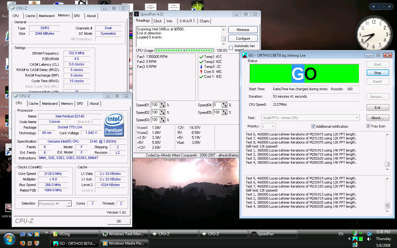

#941031 by hmhefDonor (VIP) at 2008-05-08 19:18:50 (5 years ago) - [Report]Top
well, since xi0nic brought up the idea of undervolting in my mind, :-D, i tried to achieve lowest possible voltage while having a moderate OC
this is a 1.075v, 266x8 = 2.14
comparing those temps to 1.4v , 375x8 = 3.0
that is 20c lower
considering that the ambient temp is much higher than when i did the 375x8 OC'ing
now wondering, could the undervolting cause any life span problems, or just some stability issues

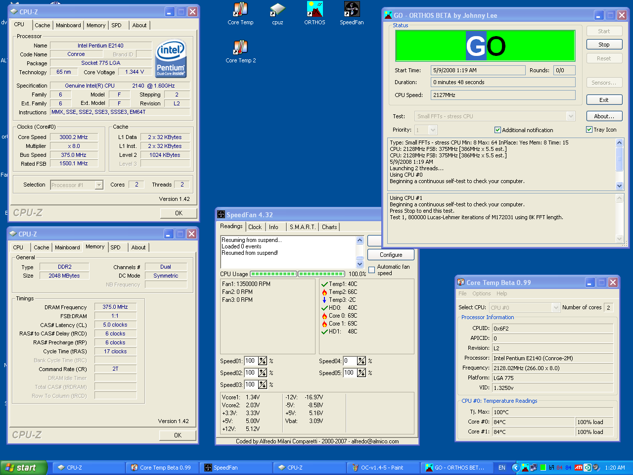

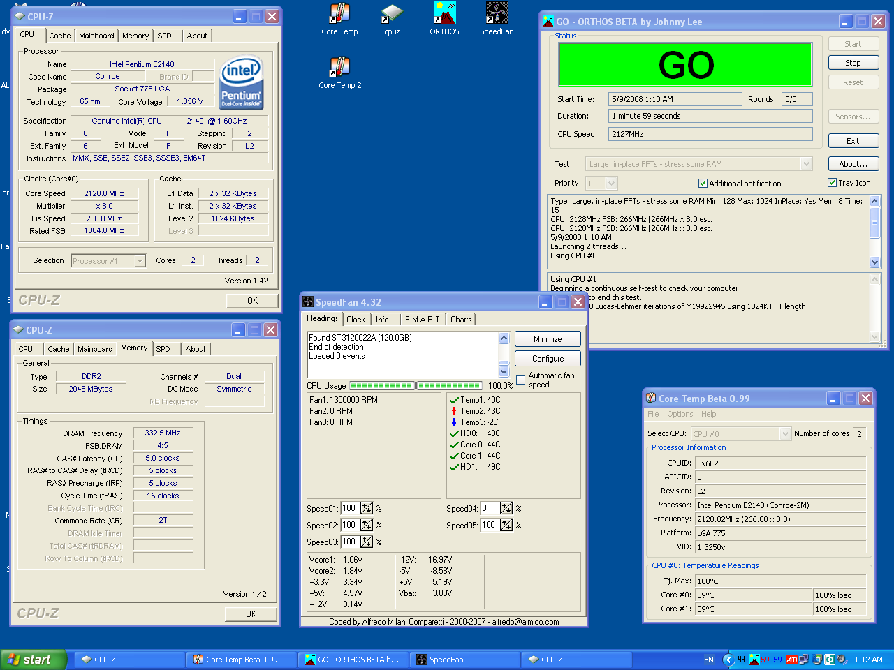

#941135 by hmhefDonor (VIP) at 2008-05-08 23:36:22 (5 years ago) - [Report]Top
isnt OCing fun ? :-D
anyway, i did use coretemp this time, and also did both to compare exactly:
1. 266x8, 1.1v (as the 1.075 turned out not so stable after 4 hours of 100% load)
2. 375x8, 1.4v, FSB +0.1v , ddr2 +0.2v
and the results : differnce of temps in idle = ~5c , in full load ~25c
didnt take screenshot of idle temps, but they where around 31~33 and 36~40 respectively
i think if i have better cooling, i could have far better OCing
and since the 1.075v was ok for 4 hours, i am expecting that the 1.1v (which is 4 steps increase) is enough to get it stable for the 12 hours :yes:
i keep wondering , WHY did intel put the stock voltage on 1.325, or the deafualt multiplier at 8, or the fsb at 200 :blink:

#941145 by hmhefDonor (VIP) at 2008-05-08 23:58:54 (5 years ago) - [Report]Top
did u notice the temps at 84c ? :rolleyes:
and i actually dont understand the thermal specification thingy, it is ~60c for a lot of processor, but what does it mean ?
actually at that clock i didnt try much playing with the voltages, but it is 1.4v in the bios not 1.344 :yes:

#941147 by Xi0nicDonor (Power User) at 2008-05-09 00:03:06 (5 years ago) - [Report]Top
Yeah but Orthos/Prime95 is designed to push your CPU.
Under normal gaming load I bet your proc won't even pass nearly 60C.
And yeah 1.4v is probably too high.
I've gotten three E2160's to 9x333 at VID which was 1.325v for all of them.  Now, I didn't even test lower volts.  They may have been stable at lower vcores (undervolting), but I didn't even test it.
You should definitely be able to hit 8x375 and keep the CPU under 60C (normal gaming load).
Ignore Orthos temps.  Setup CoreTemp logging, and run loops of 3dmark06 for about an hour.  Then end 3dmark06 and check the logs.
Then do other CPU intensive things like encoding or compressing and see what the temps do...
