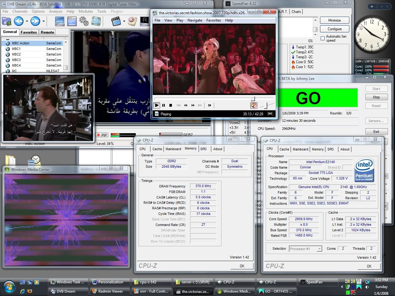

#880278 by hmhefDonor (VIP) at 2008-01-07 22:05:22 (5 years ago) - [Report]Top
well, i hit the wall :wall:
i posted before my OC results before but that turned out to be completely unstable
this pic for my e2140 8x200 OCed to 8x370 V=1.375v (stable with 80% OCing)
to OC it to 6x or 8x375 i had to set the V=1.4v (unstable)
@fsb above 380 with cpu:ram 1:1 it didnt boot at all no matter what (v=1.5v, all other v=+0.1)

#880295 by demagh (User) at 2008-01-07 22:37:33 (5 years ago) - [Report]Top
looks like you hit the wall with this processor, i guess you should stick with 370FSB

#880300 by Xi0nicDonor (Power User) at 2008-01-07 22:43:08 (5 years ago) - [Report]Top
Why are you watching like 4 tv shows while testing?
#880318 by demagh (User) at 2008-01-07 23:00:24 (5 years ago) - [Report]Top

#880320 by hmhefDonor (VIP) at 2008-01-07 23:01:46 (5 years ago) - [Report]Top
demagh wrote:
couple of questions though?
- did it boot on any other thing other than 1:1?
>> the 1:1 gives me the lowest possible ram bus any other option would give me ram 900+ so i'm guessing it wont work for the ram limitation

@Xi0nic
no just 3 :whistle:, the media center is a mp3 with the visualization thing
#880322 by Xi0nicDonor (Power User) at 2008-01-07 23:02:34 (5 years ago) - [Report]Top
Well that doesn't answer the question, does it?
#880333 by hmhefDonor (VIP) at 2008-01-07 23:21:34 (5 years ago) - [Report]Top
if u want to say something just say it :cool:
i wanted to test stability, as normaly i would be watching and recodrding a channel and want to see what on another one, this is while i'm browsing, emailing; i usually multi-multi-task
edit
how many channels do u usually watch at a time :-P
#880337 by Xi0nicDonor (Power User) at 2008-01-07 23:27:38 (5 years ago) - [Report]Top
Normally while you multitask, do you run Orthos in the background for fun?
Do you even know what Orthos does?
#880349 by hmhefDonor (VIP) at 2008-01-07 23:36:44 (5 years ago) - [Report]Top
yah, i like orthos colors, i always had a thing for its green color :-P
what i know is: it doesnt test graphics stabllity, the stuff that depends on GFX processor power like some video codecs and HD movies, also doesn't test peripherals(TV-Tunners) , right?

any advice is appreciated.
coretemp reports 43-48 idle temps and 60-75 load temps currently at 300 fsb x10 =3 ghz
some screenies at idle, load, of some benchmarks etc.
and 3d mark score of 11323.. not bad improvement from 10081 ..oc'ed to 3ghz from 2.5 and 8800gt running at 738/950

@Shamanaaa
CoreTemp isnot working for me under vista64, but its temp is supposed to be speedfan+15
50--->65
52--->67
i also posted my coretemps before here (look up a couple of posts)
anyway, ur temps are a little bit high, i'm guessing u r using the stock fan, with the stock thermal paste
if u r having instability issues at higher clocks it is because the temps/ram, not the processor limit
i recommend that u get a good thermal paste, clean the thermal paste already their(on cpu/fan) with a tissue, and put some of the new paste(i'm using a paste that is white color not sure what brand)
btw: dont EVER set the voltage above 1.5, some people people on other forums say that they use 1.7v but intel think u should stick to 1.5 as max
http://processorfinder.intel.com/detail … Spec=SLA8Y
why is ur ram multiplier is 5:6 ??
set ur ram multiplier to the lowest 2.0 or 1:1 this should give u some extra cpu speed
