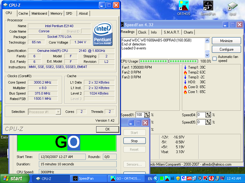

well,
i'm done OC my new e2140 1.6Ghz @3.0Ghz
with:
Gigabyte GA-P31-DS3L
and kingstone ddr2-667 valueram
1st i made sure that i was able to OC the ram from 667 to 800, of course i had to lower the timing to 5-6-6-17 and with FSB:RAM ratio = 5:6 (FSB333, ram800)
then with FSB:ram = 1:1
i finally hit the FSB wall of my e2140 between 400 and 375
the vcore was 1.4v
increased the ram by +0.4v
increased every other volt with +0.1v
those volts just to be safe stability wise, for sure i will not keeping over volting my pc
@Xi0nic
it is Weired that the website of gigabyte is outdated :look:
edit:
on stock cooling :
idle @30c, full load @65c

temps are far to high
#875303 by Xi0nicDonor (Power User) at 2007-12-29 23:07:19 (5 years ago) - [Report]Top
Lord have mercy, if SpeedFan is showing 65C... I'm scared to see your CoreTemp!
Screenshot your memory tab, please.

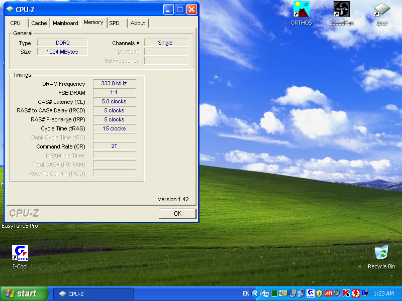

#875324 by hmhefDonor (VIP) at 2007-12-29 23:37:18 (5 years ago) - [Report]Top
this my current memory timings,
when i tested max FSB for the ram it was : 399 , 5:6 , 5.0 , 6 , 6 , 17
about the temps , those temps i guess are high because of the high volts or high FSB-375 or something

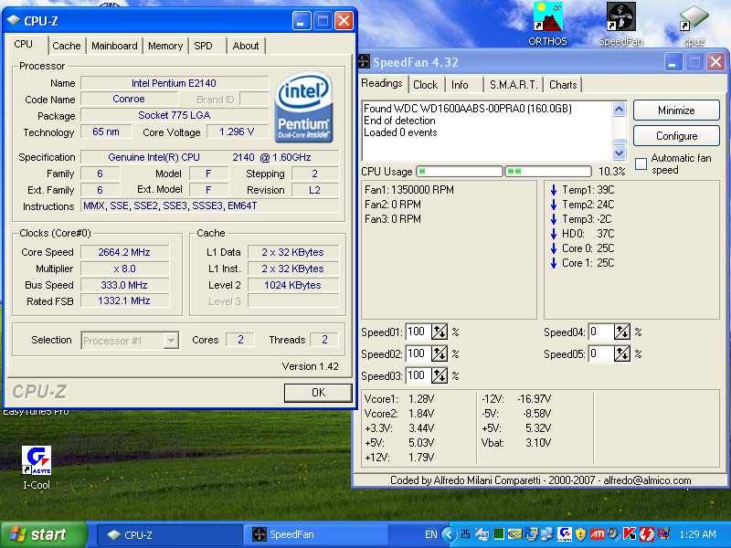

currently i run @2.6 with FSB333 ,
temps: idle @23c , fullload @55c

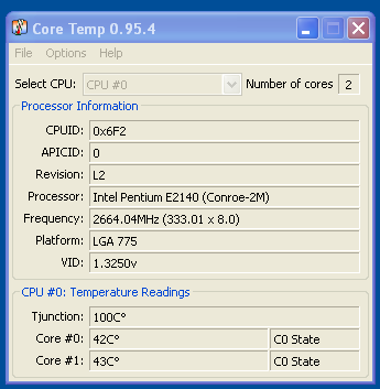

just got coretemp
idle:
is this temps are bad ?, i tried touching the heatsink under the cpu fan and it wasn't that hot, could it be the fan not touching the cpu right ?
#875337 by Xi0nicDonor (Power User) at 2007-12-29 23:54:19 (5 years ago) - [Report]Top
Describe how you mounted the heatsink.
It's pretty straight-forward, but a lot of people forget to clamp the pins down properly...
Also if you used the stock paste, I'd recommend buying some better stuff (Arctic Silver 5 or the diamond one would also work), and remount the heatsink + use the new paste.
The AS5 should cut some degrees off your temps.
