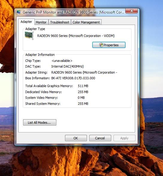

Do you guys think it is possible to overclock a Ati 9600 256mb? where can i find information on this? Thanks.
and i purchased a 256 mb video card, why does it say i have 511mb in total? can i edit it and lower the shared memory and raise the dedicated memory? (i think its the other way around )
heres some info on it.
-- 256 on board "maening 256 installed on the PCB of ur vga card"+ 255 from the installed memory in your system, i.e: System installed memory modules.
-- check the bios settings, or the vga card driver settings, i myself didn't see before a 9600 card sharing system memory
